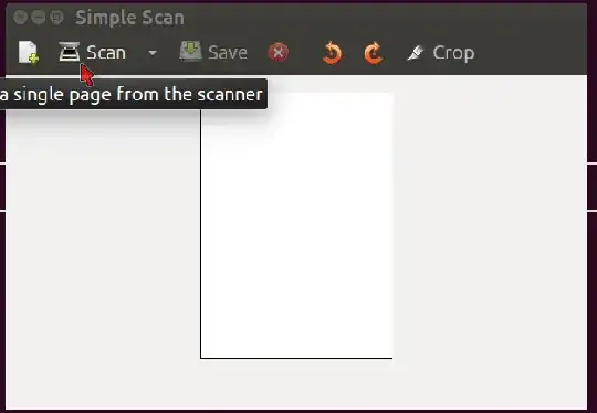

When I open Simple Scan, it tells me I have a Brother scanner but that I need to install the drivers.

However, SimpleScan still says no devices are recognised.

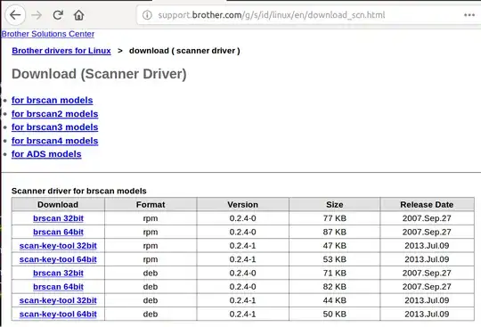

Your question contains no less than 15 links and I noticed the site of your first link is out-dated:

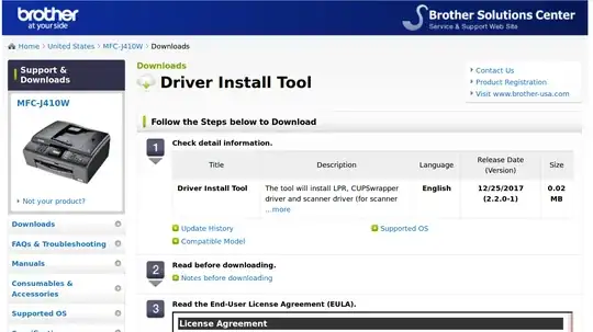

Brother Scanner Old
The Ubuntu Forums Q&A I linked above contains a more current installation tool link:
Brother Scanner New
Notice the Release Date is Christmas 2017, only a few months old.
Rather than repeating your steps I'll start a fresh install (of the scanner only) using the Ubuntu Forums link above.

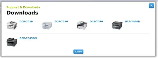

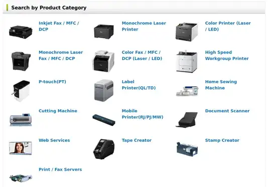

Installation Step 1 - Select Printer

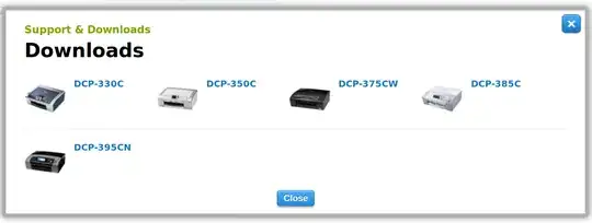

Start by selecting the right product. In the printer icon for MFC-J410W, click the link Not your product? and a selection page appears:
Brother Scanner Model Select
Your printer can be found in the first icon which has a sub-menu for "DCP 3 Series" which leads to your specific model:
Brother Scanner Model DCP-350C
My printer is the fourth icon in the panel, which being 3 icons wide is immediately below yours. I'll select that and it has a sub-menu for "DCP 7 Series" which after clicking presents:
Brother Scanner Model DCP-7065DN
I'll click on DCP-7065DN. You would have already selected DCP-350C on the previous screen shot.

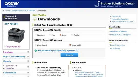

Installation Step 2 - Select Operating System (OS)
After selecting the printer model you are asked for your OS. It defaults to Linux and ".rpm". The default is ".rpm" which stands for Red Hat or Arch Linux or something like that. Change the distro to ".deb" which stands Debian which is really Ubuntu.
Click the Search button.

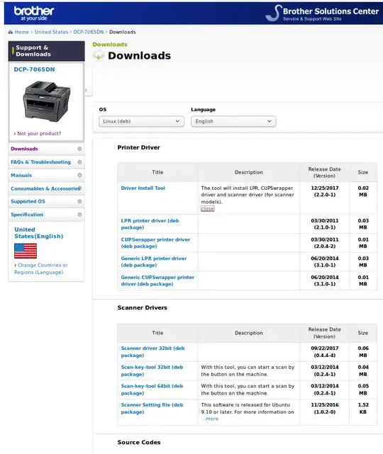

Installation Step 3 - Download Software

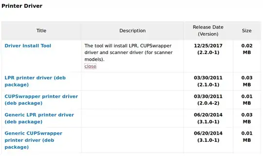

Now that the preliminaries are finished and the Command Line aficionados and GUI haters in Ubuntu-Verse have put my name on their dart boards we get to select the software to download:
The model icon in the top-left corner should be DCP-350C for you but it is DCP-7065DN for me.

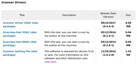

The first section is for printer drivers but we don't need that as both our printers print fine. The last section is for source code but we don't need that. If we did we probably wouldn't be on this website. The middle section contains the scanner drivers:
Here we need to select the architecture: 32-bit or 64-bit.
I've read a 32-bit driver won't work on my 64-bit arch so I'm only going to download #3 & #4 for now. I may come back and grab #1 if I need the driver?

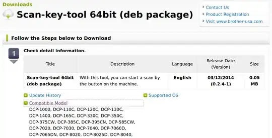

Installation Step 3-A)
Download Scan-key-tool 64bit (deb package)
After selecting #3 scanner option we see your model number on line #2 and my model number on the last line (of the screen shot)...:
...So assuming all works well for me it should all work well for you!
You need to agree to the EULA (End User License Agreement) and then download the .deb file.
The file downloaded is:
  • brscan-skey-0.2.4-1.amd64.deb, size 50.9 KB, date 03/12/2014

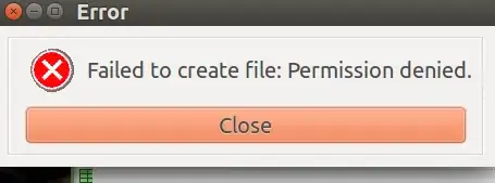

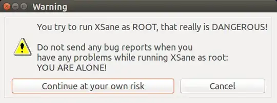

After installing type xsane in the terminal and get:
After closing the error message, xsane tries to scan for devices and eventually replies there are none. Oh Joy, Oh Bliss. The Brother website says scanning is designed to be done as root so we'll type sudo xsane and now we see:
Sounds scary but regular user couldn't find a scanner so let's see if sudo does. Select Continue at your own risk button. After window greys out for a few momments the same response as regular user appears: No devices available.

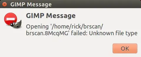

Using the scan key on the Brother MFC generates this message:
Well at least there is communication between scanner and computer because gimp started up automatically.

Step 6 - Go back and download CUPS Wrapper

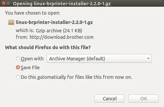

Rebooting didn't work so I'll go back and install the CUPS Wrapper tool dated 12/25/2017 which has not been installed on my system. You have an older version of on your system:
There are five download packages. When downloading the first one (CUPSwrapper) this dialog box appears:
  • Change option from Open to Save!
  • Click OK
Open terminal, change to ~/Downloads and verify file exists:
rick@alien:~/Downloads$ ll *.gz*
-rw-rw-r-- 1 rick rick    24666 Mar 11 08:24 linux-brprinter-installer-2.2.0-1.gz
After downloading these instructions appear on the website. Abbreviated format follows:
rick@alien:~/Downloads$ gunzip linux-brprinter-installer-2.2.0-1.gz
rick@alien:~/Downloads$ sudo su
root@alien:/home/rick/Downloads#
root@alien:/home/rick/Downloads# bash linux-brprinter-installer-2.2.0-1 DCP-7065DN # Change DCP-7065DN to DCP-350C

rick@alien:~$ simple-scan
After all the hard work we are rewarded with a scan:
Brother simple scan sans sudo
