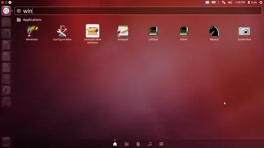

Search for wine in Dash. Select Uninstall Wine software there. There you can find all the softwares and will have option to uninstall.
A screen shot of <code>Uninstall Wine software</code> option

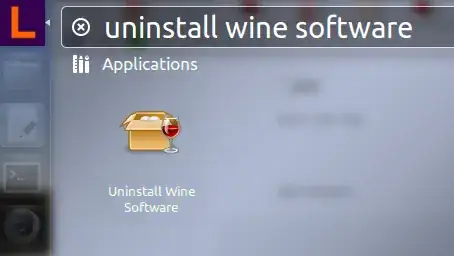

Type "unistall wine software" in your dash and open the application.

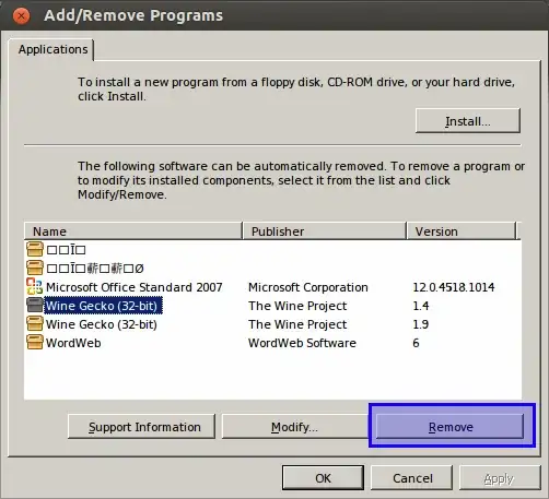

You will see the list of applications installed, click on the one you want to unistall and click on "Remove".
remove installed application

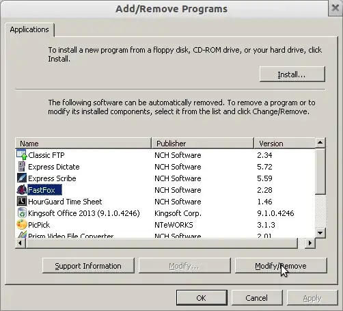

I have found the answer! On the Wine menu, I clicked on "Uninstall Wine Software".
This opens an add/remove window. I just select the app and then click the "Modify/Remove" button.
Removing a Windows program in Wine

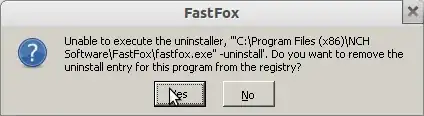

However, for some reasons that I can't understand, I have to do the same operation twice. After clicking OK three times, I still see the program on the list! When I select it and then click again on the "Modify/Remove" button I get this:
I click the "Yes" button and, finally, the app disappears from the list. But after that, I have to clean the shortcuts and folder manually. I wish I could find an easier and cleaner solution, but this one works fine anyway.
