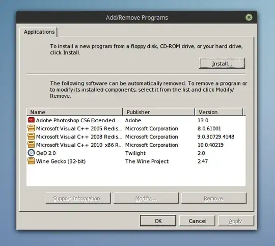

Removing the .wine folder delete ALL your content. To simply remove one or multiple specific programs, run in a terminal:
wine uninstaller
Screenshot
