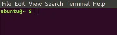

I've encountered similar problems in the past. As ever in these situations, the details matter. One solution that has worked for me is to boot the live image, "change root" into the not-working installed image, and use the live-setup's networking to allow the normal update procedure to properly install things. The precise procedure below:
  1. Boot the live image (e.g., USB, CD)
  2. Install Ubuntu to the HDD/SSD as per usual. Two details:
    1. As an aside, consider making multiple partitions, at least one for / and one for /home. This will make future updates or installations much easier. However, unless you know what you're doing, I might suggest sticking with the ext4 filesystem on each partition (unlike the link).
    2. I've generally had better luck not installing updates during this part of the process. You're choice of course, but we'll be doing the updates below, and the whole process at least feels faster if done later.
  3. When the installation finishes "Continue Testing" and don't reboot.
  4. Mount the newly minted root (/) partition by clicking the icon (one of the new gray platter/HDD looking items on the vertical bar to the left)
  5. Open a terminal ("Ack! I know!") via Ctrl+Alt+t -> A purple-looking window will appear
    Terminal example (cropped), akin to Live-image Ubuntu
  6. By clicking on the icon in step 2, Ubuntu Live mounted the hard drive to a directory in /media/ubuntu/. It will potentially be a weird directory name (technically a GUID), like 2801b1ba-d7d4-22e1-a6e3-0abcab51f05a. Task: "Change Root" into that directory with:
    sudo chroot /media/ubuntu/<directory_name>
  7. At this point, the shell (terminal) will run all commands as if on the new system, but with access to the working networking of the running kernel (the Live image). So, try a simple update and dist-upgrade (the command line equivalent to what the GUI does when updating your packages) and with luck, the correct packages will install themselves It doesn't always work, but this has been a surprisingly "simple" fix to a number of Live-boot vs installed-boot issues I've encountered:
    apt-get update
    apt-get dist-upgrade
I may have missed a step in terms of getting networking setup; if so, please leave a comment, and I'll update this answer when I can more thoroughly confirm each step of this procedure ("I'm not at my desk right now." :-) ).
