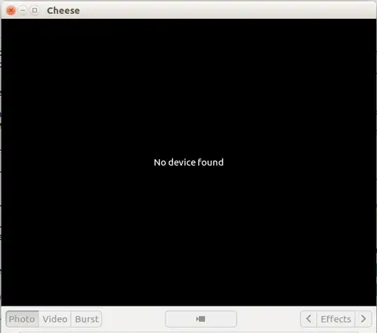

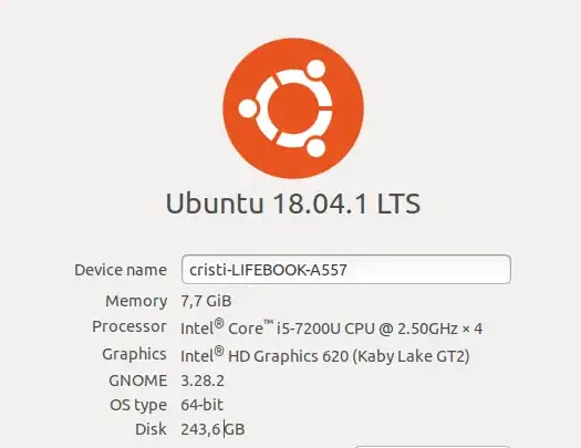

My integrated webcam is not detected by Ubuntu 18.04. Cheese indicate the message hereafter. I have a Fujitsu lifebook A Series.
** Message: cheese-application.vala:211: Error during camera setup: No device found
(cheese:7618): cheese-CRITICAL **: cheese_camera_device_get_name: assertion 'CHEESE_IS_CAMERA_DEVICE (device)' failed
(cheese:7618): GLib-CRITICAL **: g_variant_new_string: assertion 'string != NULL' failed
(cheese:7618): GLib-GIO-CRITICAL **: g_settings_schema_key_type_check: assertion 'value != NULL' failed
(cheese:7618): GLib-CRITICAL **: g_variant_get_type_string: assertion 'value != NULL' failed
(cheese:7618): GLib-GIO-CRITICAL **: g_settings_set_value: key 'camera' in 'org.gnome.Cheese' expects type 's', but a GVariant of type '(null)' was given
** (cheese:7618): CRITICAL **: cheese_preferences_dialog_setup_resolutions_for_device: assertion 'device != NULL' failed

cristi@cristi-LIFEBOOK-A557:~$ sudo modprobe uvcvideo
[sudo] password for cristi:
cristi@cristi-LIFEBOOK-A557:~$ journalctl -b0 | grep uvc
aug 07 09:42:09 cristi-LIFEBOOK-A557 sudo[4328]:   cristi : TTY=pts/0 ; PWD=/home/cristi ; USER=root ; COMMAND=/sbin/modprobe uvcvideo
aug 07 09:42:09 cristi-LIFEBOOK-A557 kernel: usbcore: registered new interface driver uvcvideo
cristi@cristi-LIFEBOOK-A557:~$ mplayer -cache 128 -tv driver=v4l2:width=640:height=480 -vo xv tv://
MPlayer 1.3.0 (Debian), built with gcc-7 (C) 2000-2016 MPlayer Team
do_connect: could not connect to socket
connect: No such file or directory
Failed to open LIRC support. You will not be able to use your remote control.
Playing tv://.
Cache fill:  0.00% (0 bytes)
TV file format detected.
Selected driver: v4l2
 name: Video 4 Linux 2 input
 author: Martin Olschewski <olschewski@zpr.uni-koeln.de>
 comment: first try, more to come ;-)
v4l2: unable to open '/dev/video0': No such file or directory
v4l2: ioctl set mute failed: Bad file descriptor
v4l2: 0 frames successfully processed, 0 frames dropped.
Exiting... (End of file)
User on similar platform with the same error messages reported that problem went away after an upgrade. So you can try:
sudo apt update
sudo apt upgrade
On a different platform user said sudo cheese had to be used to make it work. In the end OP converted to uvc which was a better webcam app.
FN-F12 on a Lifebook A557 switches your camera on.
