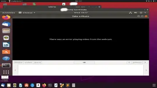

Cheese unable to play video from webcam
  • Host - 20.04
  • Guest - 18.04
  • VirtualBox - 6.1.6_Ubuntu r137129
Webcams
  • Integrated webcam : Lenovo EasyCamera
  • USB webcam : Webcam C170
Tried:
  1. Installing guest addition
  2. Updating and upgrading
  3. Adding user to vboxgroup
  4. Installing guvcview, ffmpeg, cheese
  5. sudo apt-get install build-essential linux-headers-``uname -r `
logs from the guest
dmesg|grep uvcvideo
6.170158] uvcvideo: Found UVC 1.00 device Webcam C170 (046d:082b)
6.277828] uvcvideo 1-2:1.0: Entity type for entity Processing 2 was not initialized!
6.277830] uvcvideo 1-2:1.0: Entity type for entity Extension 6 was not initialized!
6.277830] uvcvideo 1-2:1.0: Entity type for entity Camera 1 was not initialized!
6.292313] uvcvideo: Found UVC 1.00 device Lenovo EasyCamera (174f:14e8)
6.576261] uvcvideo 1-3:1.0: Entity type for entity Realtek Extended Controls Unit was not initialized!
6.576262] uvcvideo 1-3:1.0: Entity type for entity Extension 4 was not initialized!
6.576263] uvcvideo 1-3:1.0: Entity type for entity Processing 2 was not initialized!
6.576264] uvcvideo 1-3:1.0: Entity type for entity Camera 1 was not initialized!
6.577563] usbcore: registered new interface driver uvcvideo
ls /dev/video:
/dev/video0  /dev/video1  /dev/video2  /dev/video3
lsusb:
Bus 001 Device 004: ID 174f:14e8 Syntek
Bus 001 Device 003: ID 046d:082b Logitech, Inc. Webcam C170
Bus 001 Device 002: ID 80ee:0021 VirtualBox USB Tablet
Bus 001 Device 001: ID 1d6b:0001 Linux Foundation 1.1 root hub6.170158]
lsmod | grep uvc:
uvcvideo               94208  0
videobuf2_vmalloc      20480  1 uvcvideo
videobuf2_v4l2         24576  1 uvcvideo
videobuf2_common       45056  2 videobuf2_v4l2,uvcvideo
videodev              200704  3 videobuf2_v4l2,uvcvideo,videobuf2_common
media                  53248  4 videodev,videobuf2_v4l2,uvcvideo,videobuf2_common
sudo lsusb -v |grep Camera:
iProduct                1 Lenovo EasyCamera
iConfiguration          4 USB Camera
iFunction               5 Lenovo EasyCamera
iInterface              5 Lenovo EasyCamera
wTerminalType      0x0201 Camera Sensor
journalctl -b0 | grep uvc:
May 06 17:01:53 eyebies-VirtualBox kernel: uvcvideo: Found UVC 1.00 device Webcam C170 (046d:082b)
May 06 17:01:54 eyebies-VirtualBox kernel: uvcvideo 1-2:1.0: Entity type for entity Processing 2 was not initialized!
May 06 17:01:54 eyebies-VirtualBox kernel: uvcvideo 1-2:1.0: Entity type for entity Extension 6 was not initialized!
May 06 17:01:54 eyebies-VirtualBox kernel: uvcvideo 1-2:1.0: Entity type for entity Camera 1 was not initialized!
May 06 17:01:54 eyebies-VirtualBox kernel: uvcvideo: Found UVC 1.00 device Lenovo EasyCamera (174f:14e8)
May 06 17:01:54 eyebies-VirtualBox kernel: uvcvideo 1-3:1.0: Entity type for entity Realtek Extended Controls Unit was not initialized!
May 06 17:01:54 eyebies-VirtualBox kernel: uvcvideo 1-3:1.0: Entity type for entity Extension 4 was not initialized!
May 06 17:01:54 eyebies-VirtualBox kernel: uvcvideo 1-3:1.0: Entity type for entity Processing 2 was not initialized!
May 06 17:01:54 eyebies-VirtualBox kernel: uvcvideo 1-3:1.0: Entity type for entity Camera 1 was not initialized!
May 06 17:01:54 eyebies-VirtualBox kernel: usbcore: registered new interface driver uvcvideo
May 06 18:55:00 eyebies-VirtualBox sudo[8787]:  eyebies : TTY=pts/3 ; PWD=/home/eyebies ; USER=root ; COMMAND=/sbin/modprobe uvcvideo
Cheese
Failed to allocate required memory.: gstv4l2src.c(658): gst_v4l2src_decide_allocation (): /GstCameraBin:camerabin/GstWrapperCameraBinSrc:camera_source/GstBin:bin18/GstV4l2Src:v4l2src1:
Buffer pool activation failed

I re-installed the extension pack, selected xHCI USB controller instead of the OHCI. Both the webcams (integrated and USB) work!
