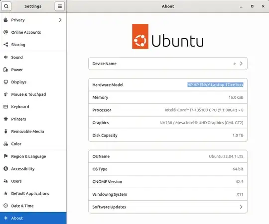

the about screen shows the following system info:
about
