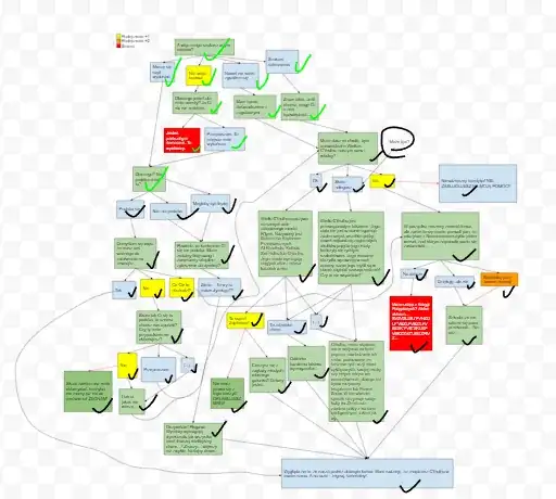

Is there any software for making non-linear story or dialogues? I tried MS Word/Google Docs but that's not good for dialogues. In one complicated dialogue I wrote in Google Drawings, it looks like this
Some dialogue
(Ignore those ticks; I think it's not final version - I see some problems here) As you can see, all ways lead to the bottom node (except red arrows - which lead to game over) It was pretty hard to make it, especially those long arrows - even now when I opened it, Chrome barely could do it - it was lagging as hell
What software are you using? Or maybe there's a software dedicated to make non-linear story?
