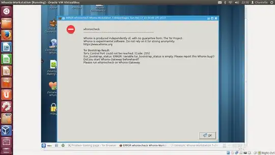

Whenever I try to run the Whonix Network Time Syncing from the Workstation I keep getting the following error message:
You can only see the image, when you are logged into stackexchange.
However whenever I run Network Time Syncing in Gateway, It will sit at about 10% in the status bar and wont move, even after leaving it for almost an hour.
I have my System clock set to exactly the same as the Whonix internal clock (UTC time) But I still cant connect through the Tor Browser.
Any Ideas?
What does whonixcheck say?
What does sdwdate's log say?
To find that out, run.
tail -f /var/log/sdwdate.log
Add this information using the comment function and I will update this answer.
This is wrong. And you shouldn't try such things without being told so in documentation or without knowing what you are doing. Leave your host's (the host is the system you were using without knowing about Whonix) system clock to what it is usually set, i.e. your usual time zone and your current time.
I think it's likely, that Tor isn't able to connect in the first place. Running whonixcheck on Whonix-Gateway will tell. Are you living in a censored area (rhetoric question)? Have you followed the recommendation to learn how to use the Tor Browser Bundle on your host first? Does that work for you?
