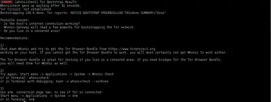

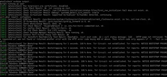

I am trying to sync the time on both whonix gateway and workstation but am getting the following connectivity errors upon running whonixcheck with the verbose flag set. On the gateway I get:
$ whonixcheck --verbose
whonix check 1
whonix check 2

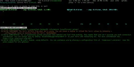

Next, when running arm on the gateway there seems to be no connection to the tor network:
whonix arm

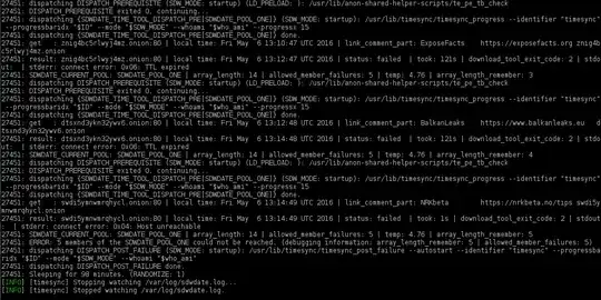

Following the steps suggested in the answer of this question the log files are:
tail -f /var/log/sdwdate.log
sdwupdate

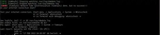

When running timesync on the gateway I get:
timesync 1 timesync 2 timesync 3 timesync 4

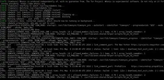

When running:

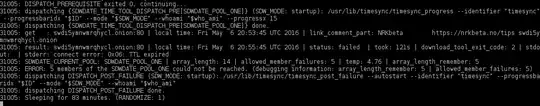

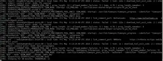

tail -f -n 20 /var/log/sdwdate.log
The following are shown:
timesync 5
