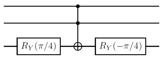

Assuming you've got Toffoli and single-qubit rotations, you can implement the following: enter image description here
This basically works because if either of the controls is not $|1\rangle$, the Toffoli does nothing and the two single-qubit unitaries cancel each other. Whereas, if both controls are $|1\rangle$, then the net gate on the target qubit is $$ (\cos\frac{\pi}{8}I+i\sin\frac{\pi}{8}Y)X(\cos\frac{\pi}{8}I-i\sin\frac{\pi}{8}Y)=X(\cos\frac{\pi}{4}I-i\sin\frac{\pi}{4}Y)=\frac{X+Z}{\sqrt2}=H. $$
