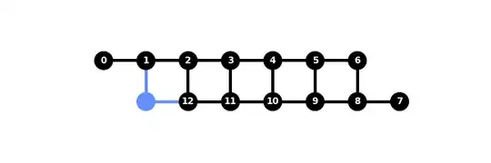

Try replacing the last three lines of the code you posted with
IBMQ.load_account()
backend = IBMQ.get_provider(hub='ibm-q').get_backend('ibmq_16_melbourne')
new_circ_lv0 = transpile(qc, backend=backend, optimization_level=0)
plot_circuit_layout(new_circ_lv0, backend)
and add the necessary import statements (plot_circuit_layout is in qiskit.visualization). This should give you the mapping from your logical qubits to physical qubits on ibmq_16_melbourne, with optimization level 0:
physical qubits
For more information, this tutorial will probably be more helpful for this task than the one you linked.
