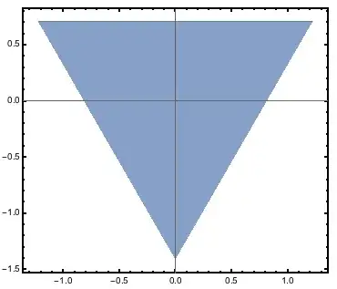

$Z^{(1)}, Z^{(2)}$ section
These coordinates only depend on the $\alpha,\beta$ parameters. It follows that the full space is contained in a sort of "tubular region" with the following triangular 2D section:
ParametricPlot[{expvalZ1[\[Alpha], \[Beta]],
  expvalZ2[\[Alpha], \[Beta]]}, {\[Alpha], 0, Pi}, {\[Beta], 0, Pi}]
So again, most definitely not what a hypersphere would look like.

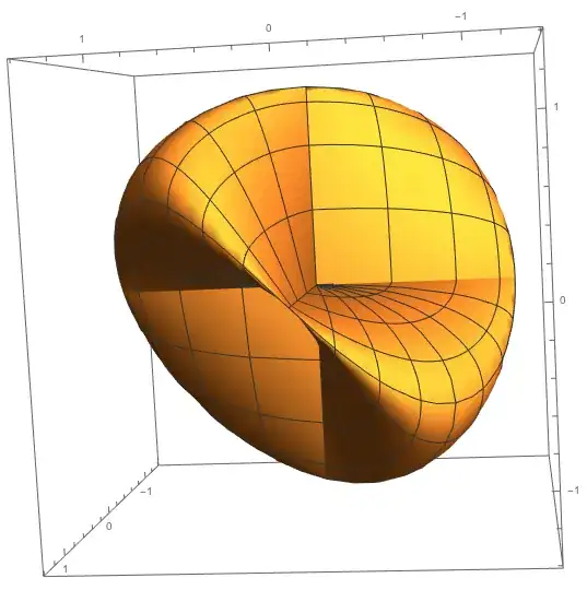

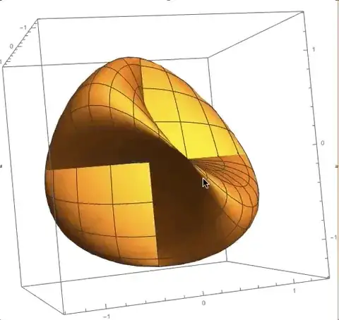

Three-dimensional $X^{(ij)}$ section
This is where it starts to look pretty cool.
If we vary $\alpha,\beta$ for $\theta,\phi$ fixed, we get this nice 3D shape (sorry for the poor quality, SE doesn't allow more than 2MB for images):

Changing the values of $\phi,\theta$ mostly just changes the scales of the surface, without modifying its structure. Here is a better quality, still picture of this surface:
The $Y^{(ij)}$ sections have pretty much the same structure, modulo changing the values of $\phi,\theta$.
So yea, in conclusion, definitely not a hypersphere.
