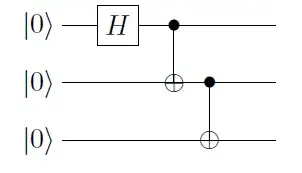

  1. Yes, in the circuit the qubit "enters" to the left, and exits to the right, but when applying the gates to a state you must apply the one on the far left first, then the next and so on, so concretely you do write them down right to left, but it's just a consequence of writing the operator that we want to apply on the left of the vector, while our natural way of writing dictates a "time direction" left to right. As an example the following circuit
implements the operation
$$(I\otimes \mathrm{CNOT})(\mathrm{CNOT}\otimes I)(H\otimes I\otimes I)|000\rangle $$
