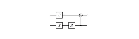

Neither of these gates require approximate sequences. You can implement them exactly with your specified gate sets with no great effort.
Up to a global phase (which should be irrelevant), G is simply $HSH$.

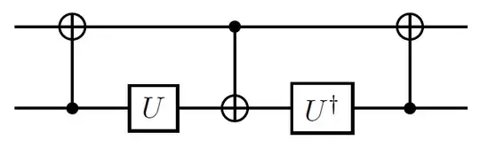

The second, $W$, is a little more complicated. The way that I constructed this was to think of it as a controlled-Hadamard where I then required a basis change which is created by a controlled-not. One therefore has the circuit
where $U=\cos\frac{\pi}{8}\mathbb{I}-i\sin\frac{\pi}{8}Y$. I always get factors of 2 wrong in these angles, but this is of the form $R_Y(\theta)$. I've taken no particular effort to optimise this gate sequence, but this is probably fairly good.
