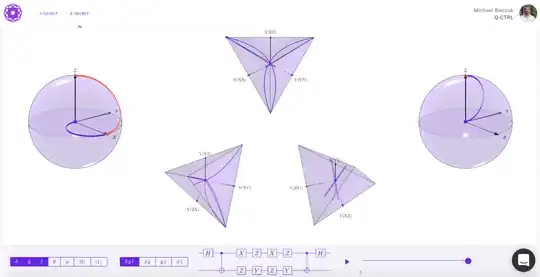

We have some multiqubit visualizations within Q-CTRL's Black Opal package.
These are all fully interactive and are designed to help build intuition about correlations in interacting two-qubit systems.
The two Bloch spheres represent the relevant separable states of two qubits. The tetrahedra in the middle visually capture correlations between certain projections of the two qubits. When there is no entanglement, the Bloch vectors live entirely on the surfaces of the respective spheres. However, a fully entangled state lives exclusively in the space of correlations in this representation. The extrema of these spaces will always be maximally entangled states like Bell states, but maximally entangled states can also reside within multiple tetrahedra simultaneously.

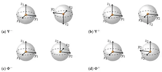

Pure two-qubit states may be represented by just two Bloch Spheres. This article explains how to do it. The division into separable and maximally entangled part is done as in the first answer. The maximally entangled part gets represented by the relative directions of coordinate axes of two Bloch Spheres. The key point is that the coordinate axes of the Bloch Spheres must have different handedness. Here is how Bell states are represented in this paper.
Representations of Bell states.

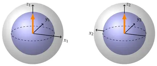

There are illustrations of the CNOT gate action (Figures 9, 10, 11) in the paper and also an illustration of entanglement and disentanglement process (Figure 14). Visually the process of entanglement looks like a gradual reflection of one of the Bloch Sphere's coordinate axes, given some plane of reflection. Here is an illustration of a partially entangled state. Note how the x-axis of the second BS is partially inverted. Here the representations of separable and maximally entangled state have been combined into two Bloch Spheres of radius 1 each.
Partially entangled state.
