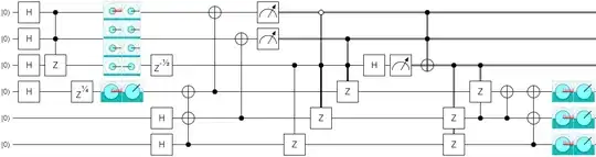

Quirk (algassert.com/quirk) runs in browsers and can be used to create simple circuit diagrams. I use it for this purpose all of the time, though it's main purpose is to simulate circuits.
Just drag the gates you want into the circuit, perhaps use the simulation results to check that everything is behaving correctly, and then take a screenshot with e.g. Windows' Snipping Tool. Most browsers also have an option to turn a canvas into an image (e.g. in firefox if you right-click on the circuit you can select 'view image' that you can then download and crop). You can bookmark the circuit to come back to it later, in case you make a small mistake.
The main downside of this approach is a) it requires manual work every time, b) it produces bitmap images instead of vector images, and c) it is somewhat inflexible (e.g. you can't put operations with different controls into the same column).
Example:

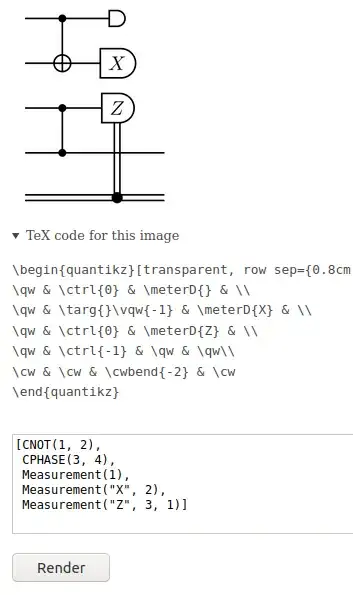

For drawing in your browser, there is a demo of the Quantikz.jl package you can use:
A quantikz example
Various programming languages have their own circuit drawing libraries as well. For latex code probably the best choice is Quantikz, and if you are programming in Julia you can create a diagram (png or latex code) with the Quantikz.jl library.

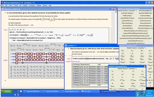

One of the best tools to use is the "Quantum Computing" package in Mathematica: http://homepage.cem.itesm.mx/jose.luis.gomez/quantum/
Here you can just input all the useful gates directly and also completely manipulate the Circuits in a complete GUI interface. Screenshot is taken from Gomez's webpage
Moreover, you can also perform all the desired operations over qubits.
