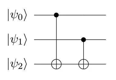

So, let's start over: take three qubits, define the first two as your input registers and the third as your output register. Then, what you want your operation to do, is this: $${\rm U}_f|000\rangle=|000\rangle\\ {\rm U}_f|010\rangle=|011\rangle\\ {\rm U}_f|100\rangle=|101\rangle\\ {\rm U}_f|110\rangle=|110\rangle$$ Note that to fully define ${\rm U}_f$, we would have to determine a desired output for the four other possible (computational basis) input states, $|\!*\!*1\rangle$. How we do this is entirely up to us! (As long as ${\rm U}_f$ remains unitary, of course.) So we can just choose something convenient, such as this: $${\rm U}_f|001\rangle=|001\rangle\\ {\rm U}_f|011\rangle=|010\rangle\\ {\rm U}_f|101\rangle=|100\rangle\\ {\rm U}_f|111\rangle=|111\rangle$$ This has the following matrix form: $${\rm U}_f=\begin{bmatrix} 1&0&0&0&0&0&0&0\\ 0&1&0&0&0&0&0&0\\ 0&0&0&1&0&0&0&0\\ 0&0&1&0&0&0&0&0\\ 0&0&0&0&0&1&0&0\\ 0&0&0&0&1&0&0&0\\ 0&0&0&0&0&0&1&0\\ 0&0&0&0&0&0&0&1 \end{bmatrix}$$ Intuitively, this unitary is constructed with two CNOT gates, which swap the third qubit $|0\rangle\to|1\rangle$ or $|1\rangle\to|0\rangle$ if and only if one of the first two qubits is in a $|1\rangle$ state:
You can check that multiplying the matrices of the two CNOTs indeed gives the same ${\rm U}_f$.

In this case, the implementation is straightforward. This is a first CNOT with first qubit of register $x$ as control and the output qubit as target followed by another CNOT with the second qubit of $x$ as control. If you input $x=00$, nothing happens. If $x=01$ or $10$, you apply one CNOT which adds $1$ to the target (definition of CNOT). If $x=11$, the two CNOTs are applied so you add $1$ to the target twice and $1 + 1 = 0$ when having one output bit.
To get the unitary, you can just take the unitary matrix of the CNOT, tensor product with the identity matrix (but respect the order when you write). You do this for the first CNOT giving you one unitary $U_1$, then the second giving $U_2$ and finally multiply $U_2 U_1$ to get your unitary operator.
