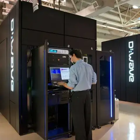

  1. Is quantum computing independent (e.g Quantum+LCD+Keyboard) or it add-on for PC (e.g GPU)? / Can I use a quantum computer directly or must connect it to PC?
Think of it more like a GPU accelerator. Use a classical keyboard and mouse to give it commands, and a classical LCD screen to see the output, but allow the calculations to happen on a device that involves qubits.
Here's a famous picture of someone using a classical keyboard and classical LCD when using a quantum annealer:
