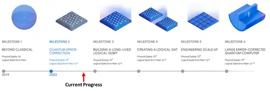

Google has made an announce about its new Willow quantum chip.
Here is their roadmap :enter image description here
which claims to have reached efficient error correction with 100 qubits.

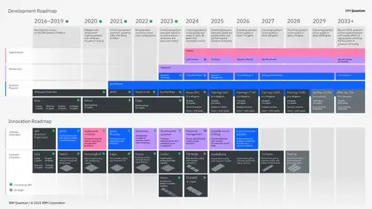

On the other hand, I was aware of IBM's roadmap : enter image description here
which plans error correction enabled QPUs by 2029 (in 4 years), with 200 qubits.
I am quite surprised that Google has already reached this milestone comparatively to IBM, as they use the same qubit technology, superconducting circuits (perhaps with some minor differences) and that IBM target, 200 qubits, is in the same order of magnitude as Google.

As for IBM’s roadmap, I think they mean that they plan to deliver a quantum system named “Starling” with 200 logical qubits by 2029. Google encoded one (relatively noisy) logical qubit using ~100 physical qubits. My honest opinion - I will be very surprised if indeed anyone will be able to deliver high-quality 200 superconducting-based logical qubits by 2029.

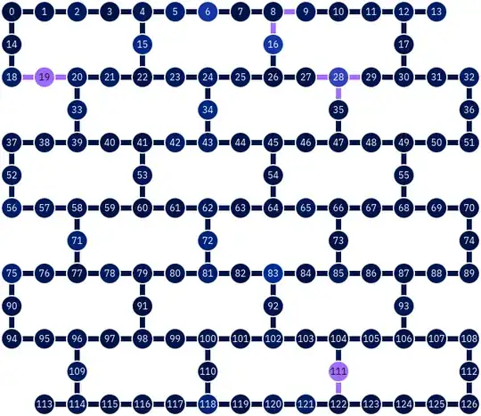

IBM constantly present QPUs manifesting the “heavy-hex” topology - with poor qubit-connectivity and not suitable for the surface code:
Fabricating high-fidelity qubits with high connectivity compared to low connectivity is much harder due to crosstalks and inevitable undesired interactions between the connected components.
