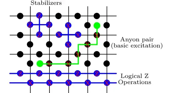

I'll summarise some of the basic properties of the Toric code. Imagine a square lattice with periodic boundary conditions, i.e. the top edge is joined to the bottom edge, and the left edge is joined to the right edge. If you try this with a sheet of paper, you'll find you get a doughnut shape, or torus. On this lattice, we place a qubit on each edge of a square.
Stabilizers
Next, we define a whole bunch of operators. For every square on the lattice (comprising 4 qubits in the middle of each edge), we write $$ B_p=XXXX, $$ acting a Pauli-$X$ rotation on each of the 4 qubits. The label $p$ refers to 'plaquette', and is just an index so we can later count over the whole set of plaquettes. On every vertex of the lattice (surrounded by 4 qubits), we define $$ A_s=ZZZZ. $$ $s$ refers to the star shape and again, will let us sum over all such terms.

Once you have a code, with some qubits stored in the codespace, you want to keep it there. To achieve this, we need error correction. Each round of error correction comprises measuring the value of every stabilizer. Each $A_s$ and $B_p$ gives an answer $\pm 1$. This is your error syndrome. It is then up to you, depending on what error model you think applies to your system, to determine where you think the errors have occurred, and try to fix them. There's a lot of work going on into fast decoders that can perform this classical computation as efficiently as possible.
One crucial feature of the Toric code is that you do not have to identify exactly where an error has occurred to perfectly correct it; the code is degenerate. The only relevant thing is that you get rid of the errors without implementing a logical gate. For example, the green line in the figure is one of the basic errors in the system, called an anyon pair. If the sequence of $X$ rotations depicted had been enacted, then the stabilizers on the two squares with the green blobs in would have given a $-1$ answer, while all others give $+1$. To correct this, we could apply $X$ along exactly the path where the errors happened, although our error syndrome certainly doesn't give us the path information. There are many other paths of $X$ errors that would give the same syndrome. We can implement any of these, and there are two options. Either, the overall sequence of $X$ rotations forms a trivial path, or one that loops around the torus in at least on direction. If it's a trivial path (i.e. one that forms a closed path that does not loop around the torus), then we have successfully corrected the error. This is at the heart of the topological nature of the code; many paths are equivalent, and it all comes down to whether or not these loops around the torus have been completed.
