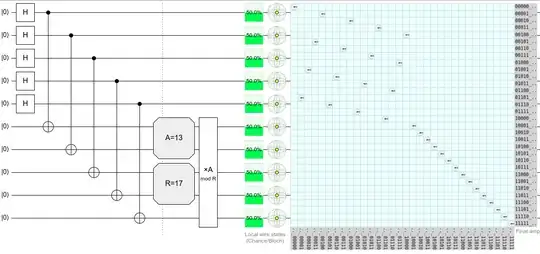

If you look at what happens inside a specified row k, this matrix is moving the 1 from column k to column k*n+1. Then it does something special in row n-1. So this is an inverse-permutation corresponding to a multiplication, then an increment, then a fixup exchanging two states.
All those operations can be implemented in O(log^2 n) gates. In fact you can get down to O(log(n) log(log(n)) log(log(log(n)))) by using Schönhage–Strassen multiplication, though that would have bad constant factors.
Basically: the hard part of your problem is multiplication. Look up how to do modular multiplication, pick a prime P larger than n^2, and then look at the permutation you get by performing an inplace modular multiplication by the multiplicative inverse of n mod P. You'll see it has this each-row-advances-n-steps property you're looking for, which you can then tweak into a full solution.

I am creating a new answer to add some detail to Craig Gidney's helpful response. As they mentioned, there are three basic steps:
  1. advance each row $n+1$ steps,
  2. fixup the $i=n-1$ row,
  3. increment all rows by $1$.
Let $Q=\text{log}(n^2)$ be the number of qubits where $n=\{4,8,16...\}$ to make $Q$ an integer.
For the first step, we can use inline multiplication to advance each row by $n+1$ steps when $n$ is even. Given the constraints of this problem, I can do this in $Q-1$ CNOT gates. For example, here are the circuits for n=4 and for n=8.
For the second step, we fixup the $i=n-1$ row by exchanging the $n^2-1$ column with the $n^2-n$ column. This is a two-level unitary permutation matrix and can be performed in at most $\mathcal{O}(Q^2)$ single qubit and CNOT gates following Nielsen and Chuang 2010 edition page 193. I don't have a general construction for this permutation matrix.
Finally, I use the most basic construction to increment each row by $1$ which requires $\mathcal{O}(Q)$ multi-controlled not gates to implement. For example, here is the increment circuit for the $Q=4$ qubit case.
Bringing everything together we have this circuit for the $n=4$ case. The first $n$ rows of my circuit match the matrix in my original question. The following $n^2-n$ rows do not match, but as I mentioned in the question, they can have any form as long as the full matrix is unitary. Though not a fully complete complexity analysis, the final complexity for the decomposition is: $\; (Q-1$ CNOT gates) + ($\mathcal{O}(Q^2)$ single qubit and CNOT gates) + ($\mathcal{O}(Q)$ multi-controlled NOT gates).
