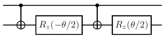

A good starting point is the following circuit: enter image description here If you work though it's action, you'll find that this is (almost) the controlled-phase that you want. (I think you also need a phase gate on the top qubit). So, then it's just a case of decomposing the phase rotations in terms of $H$ and $T$ to your desired accuracy (you'll want them each accurate to $\epsilon/2$ in order to ensure overall $\epsilon$ accuracy). This answer links to a paper and code that can do this for you. It's not something you want to do by hand!
