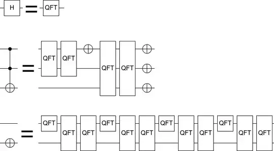

The Quantum Fourier Transform is an important primitive, but does there exist a finite gate set which is non-universal that generates the Quantum Fourier Transform?

Yes, the QFT requires universality. No, there isn't a non-universal gate set that implements the QFT. Just having the QFT as an operation is already computationally universal, because it can generate H+TOFFOLI:
Therefore anything that generates the QFT must also be computationally universal.
I bet you can prove the 2-qubit QFT is fully universal on its own, not just computationally universal, since it's non-Clifford and just randomly putting some together seems to generate weird looking angles.
