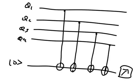

Following similar answer by @DaftWullie and @Tristan Nemoz on How to perform a state density modification for a single targeted state only? , I believe this can be done as follows:
Measuring the last bit will enforce the parity of the number of $|1\rangle$'s in $q_1q_2q_3q_4...$. If the measurement result is $|1\rangle$, discard and start over. If the measurement result is $|0\rangle$, then the remaining superposition must contain an even number of control $|1\rangle$'s in $q_1q_2q_3q_4...$ as desired.
There should exist more complex variations of this parity check to distinguish, for example, $0,1,2,3 \mod{4}$, i.e. the exact number of $|1\rangle$'s in $q_1q_2q_3q_4$...
