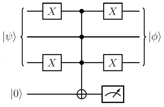

I have a question about single target state modification... Suppose we have a 3 qubit state density distribution as follows (prenormalized):
$$\begin{bmatrix} |000\rangle & 3 \\ |001\rangle & 4 \\ |010\rangle & 5 \\ |011\rangle & 6 \\ |100\rangle & 7 \\ |101\rangle & 8 \\ |110\rangle & 9 \\ |111\rangle & 10 \\ \end{bmatrix}$$
and we would like to do a "whack-a-mole" and whack $|010\rangle$ down to $0$ while keeping all the other proportions unchanged, i.e.
$$\begin{bmatrix} |000\rangle & 3 \\ |001\rangle & 4 \\ |010\rangle & \color{red}0 \\ |011\rangle & 6 \\ |100\rangle & 7 \\ |101\rangle & 8 \\ |110\rangle & 9 \\ |111\rangle & 10 \\ \end{bmatrix}$$
How might one do this using physically allowed quantum state manipulations?

You're using some unusual notation and terminology that don't entirely fit. I'm assuming you question is that you are starting from a state $$ |\psi\rangle=3|000\rangle+4|001\rangle+5|010\rangle+6|011\rangle+7|100\rangle+8|101\rangle+9|110\rangle+10|111\rangle)/\sqrt{380} $$ and you want to convert it into $$ |\phi\rangle=3|000\rangle+4|001\rangle+6|011\rangle+7|100\rangle+8|101\rangle+9|110\rangle+10|111\rangle)/\sqrt{355}. $$ You have a vast range of options for how you might do this. By far the simplest is essentially the suggestion of TristanNemoz where you run a probabilistic protocol. In terms of a quantum circuit, this looks like enter image description here
and works provided the measurement gives the answer 0, which happens with probability $\frac{355}{380}=\frac{71}{76}$. The circuit is simple, and has the further advantage that you don't actually need to know what state $|\psi\rangle$ is, only the term that you want to knock out. The disadvantage, of course, is that it is probabilistic.

The projectors $\mathcal{M}_0=|010\rangle\!\langle010|$ and $\mathcal{M}_1=I-|010\rangle\!\langle010|$ define a measurement. Applying this measurement, you will get outcome $0$ with probability $\frac{5^2}{3^2+\cdots+10^2}=\frac{5}{76}$ and outcome $1$ with probability $\frac{71}{76}\approx93.42\%$.
If you get outcome $1$, then the resulting state will be the one that you want.
