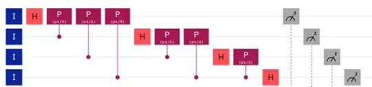

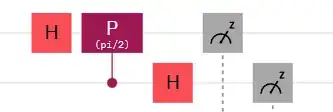

I have implemented the following 8 qubit QFT circuit similar to the following:
and loaded the coefficients as follows:

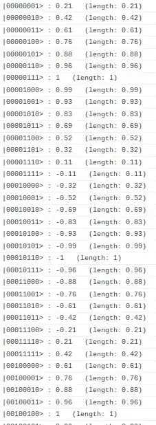

The output of the QFT is as follows:
enter image description here enter image description here enter image description here enter image description here
Could anyone help interpret the above result?

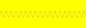

With particularly nice values of wavelength,
so the circuit seems to be filtering frequencies in some way, but how to read the "frequency" value from the above result?

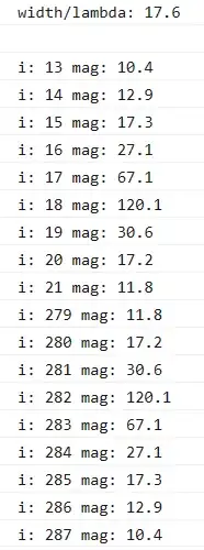

Analogous case for discrete fourier transform (300 data points):
The frequency burst at $X_{18}=120$ can be read straight off the result.

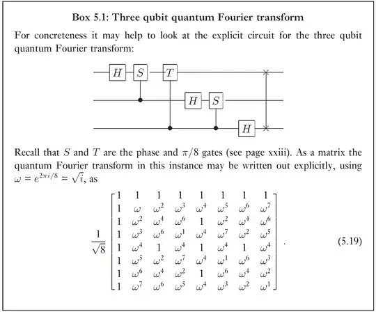

After working through the math, I found that the 3-qubit QFT density transformation is given by the matrix:
(from here)

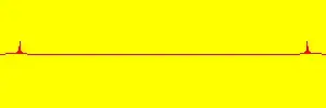

Extending to $2^8 = 256$ states,
gives the correct single Fourier spike at the right frequency index.
Therefore the error is likely in circuit construction or density state change implementation.
Algebraic verification for 2 qubit QFT circuit:
Step 0:
$$\sqrt{\frac{1}{4}}[a|00\rangle + b|01\rangle + c|10\rangle + d|11\rangle]$$
Step 1:
$$\sqrt{\frac{1}{8}}[(a+c)|00\rangle + (b+d)|01\rangle + (a-c)|10\rangle + (b-d)|11\rangle]$$
Step 2:
$$\sqrt{\frac{1}{8}}[(a+c)|00\rangle + (b+d)|01\rangle + (a-c)|10\rangle + i(b-d)|11\rangle]$$
Step 3:
$$\sqrt{\frac{1}{16}}[(a+b+c+d)|00\rangle + (a-b+c-d)|01\rangle + (a+ib-c-id)|10\rangle + (a-ib-c+id)|11\rangle]$$
$$=\sqrt{\frac{1}{16}}\begin{bmatrix}a+b+c+d \\ a-b+c-d \\ a+ib-c-id \\ a-ib-c+id \end{bmatrix}$$
Comparing with 2 qubit QFT matrix with $\omega = e^{i\frac{2\pi}{4}}$:
$$\sqrt{\frac{1}{4}}\begin{bmatrix} 1 & 1 & 1 & 1 \\ 1 & \omega & \omega^2 & \omega^3 \\ 1 & \omega^2 & \omega^4 & \omega^6 \\ 1 & \omega^3 & \omega^6 & \omega^9 \end{bmatrix} = \sqrt{\frac{1}{4}} \begin{bmatrix} 1 & 1 & 1 & 1 \\ 1 & i & -1 & -i \\ 1 & -1 & 1 & -1 \\ 1 & -i & -1 & i\end{bmatrix}\begin{bmatrix}a\\b\\c\\d\end{bmatrix}=\sqrt{\frac{1}{4}}\begin{bmatrix}a+b+c+d\\a+ib-c-id\\a-b+c-d\\a-ib-c+id\end{bmatrix}$$
The $|01\rangle, |10\rangle$ coefficient entries are reversed, which need to be post-processed.
