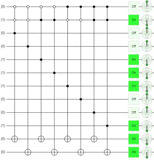

Here's a circuit that does that:enter image description here with the top 2 qubits being the control qubits, the middle 8 being the data qubits and the last 2 being the write qubits.

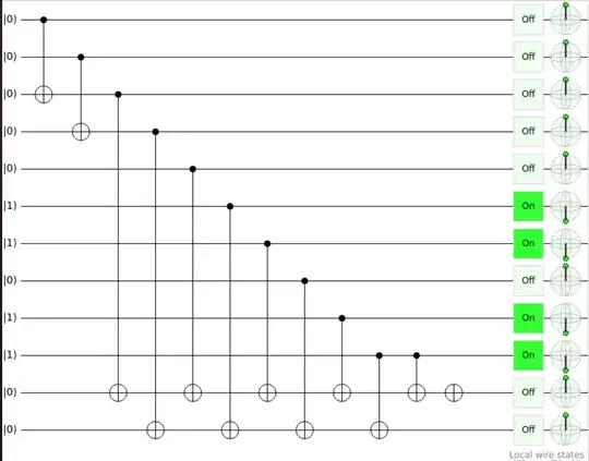

If I'm understanding you correctly, here is a circuit which does that. A screenshot of it is below.
The arrangement of qubits is the same as in Victory's answer: the top two qubits are the control inputs, the middle eight are the data inputs, and the bottom two are the outputs.
A quantum circuit implementing the desired operation
