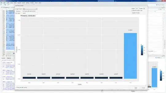

There are implementations for Grover's algorithm with an oracle for $n=3$ searching for |111>, e.g. (or see an R implementation of the same oracle below): Oracle for 111 https://quantumcomputing.stackexchange.com/a/2205
Again, my confusion is, given I do not know the position of $N$ elements in a dataset, the algorithm requires me to search for a string that encodes the position of $N$ elements. How do I know which position I should look for when the dataset is unstructured?
R code:

 result=measurement(n3)
 plotMeasurement(result)

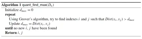

I suggest you read this article, which discussed the quantum speedup for unsupervised learning like clustering. This paper gathered the progression of the quantum algorithms to accelerate unsupervised learning, and a lot of the algorithms depend on the Grover search.
Here comes an example.
Algo 1. find maximum distance
For n points, this algorithm searches the distances(up to n^2 different distances) and it can get the distance_maximum in O(n) expected time with high probability. For proof of this claim, see this article.
But there is one thing I myself is also quite confused about, which is how to construct the oracle to compute the distance(and the crucial point are how efficient it is and whether it is asymptotically optimal). I think the building of the oracle is the major problem of Grover search, not how to get more variant applications.
