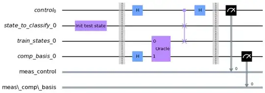

I want to run the circuit given below, but I am getting the following error.
QiskitError: "Cannot unroll the circuit to the given basis, ['u1', 'u2', 'u3', 'cx', 'id', 'unitary']. Instruction cphi_0 not found in equivalence library and no rule found to expand."
Why do you think I am encountering this error? I am sharing the codes below. What should I do to run the circuit?
Circuit

You are creating a gate from a manually-inputed unitary, and Qiskit does not know how such unitary can be decomposed out of the box.
You can either tell Qiskit transpiler not to decompose your unitary, or extend the Equivalence Library (basically, class that stores information on how gates are decomposed) to know how to decompose your gate. The answer to this question is a fantastic resource: Transpilation into custom gate set in qiskit
Since in your specific case train_data appears to be a basic identity, consider not using a custom gate at all. This way you can rely on already existing gates and you do not need to explain to transpiler how to decompose them.
