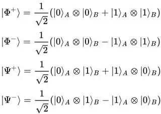

Here below you see the definition of the 4 Bell states.
The 4 bell states

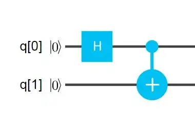

The first bell state can be easily implemented on the composer through a Hadamard gate and a CNOT gate as follows:
first Bell state

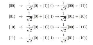

Remember that the Hadamard (H) gate maps $|0\rangle$ to $\frac{|0\rangle+|1\rangle}{\sqrt{2}}$ and $|1\rangle$ to $\frac{|0\rangle-|1\rangle}{\sqrt{2}}$, while the CNOT gate has the following conversion table:
So, you can use the same circuit:
but begin in the states $|01\rangle$, $|10\rangle$ and $|11\rangle$ to get the other three Bell states (you can easily convert to these states from $|00\rangle$ using the Pauli-X gate).

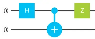

$|\Phi^-\rangle = Z_1 |\Phi^+\rangle = Z_1 \cdot \textrm{CNOT} \cdot H_1 |00 \rangle$

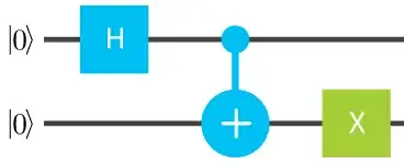

$|\Psi^+\rangle = X_2 |\Phi^+\rangle = X_2 \cdot \textrm{CNOT} \cdot H_1 |00 \rangle$

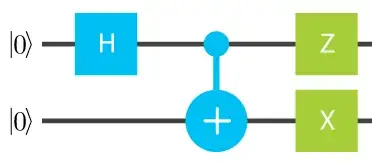

$|\Psi^-\rangle = Z_1 |\Psi^+\rangle = Z_1 \cdot X_2 \cdot \textrm{CNOT} \cdot H_1 |00 \rangle$
Where $Z_i$ and $X_i$ act on the $i^\textrm{th}$ qubit.
So here is $|\Phi^-\rangle$:
Here is $|\Psi^+\rangle$:
And here is $|\Psi^-\rangle$:
