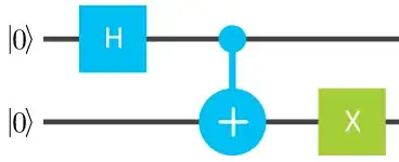

It is not two Hadamard gates.
You are 100% correct that two Hadamrd gates would put you in an equal superposition of 00, 01, 10, 11, meaning 25% chance of getting any of those.
Let's construct her gate based on the input $|00\rangle$ and the output $\frac{1}{\sqrt{2}}\left(|10\rangle +|01\rangle\right)$.
The final state is $|\Psi^+\rangle$ from this question.
So the state can be constructed with this circuit:
where the middle gate is a CNOT.
