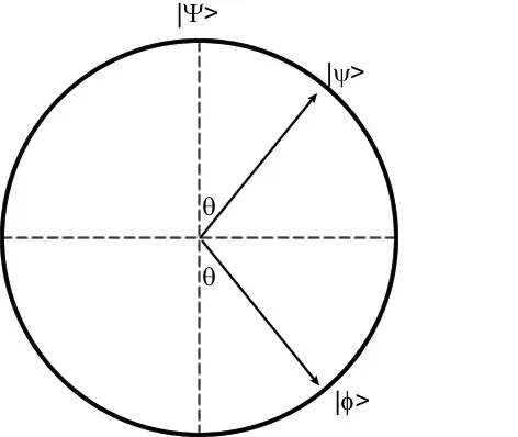

You can actually pick a better measurement basis than the one you described so that you can come to a conclusion faster (but certainly does not give you a definitive answer). Try to think about the two states $|\psi\rangle$ and $|\phi\rangle$ on the Bloch sphere. You can always find a plane passing through both points and the centre of the sphere. On this plane, there is a circle, with two points corresponding to the two states. Draw lines joining these points to the centre. Next, construct a diameter of the circle which makes equal angles with the two lines you've just drawn. This would define the measurement basis that tells you absolutely nothing about which of the two states you have. But, if you construct the diameter that is perpendicular to that line, this is the one that, at least in a single shot, has the maximum probability of distinguishing between the two states.
Here's a picture. $|\Psi\rangle$ is one of the two basis states that you want for the measurement, and remember that the angle $\theta$ can be related to $|\langle\psi|\phi\rangle|$. enter image description here
It might be worth then calculating if you have $k$ copies of each state, whether a joint measurement constructed in this way can perform better than the individual measurement repeated $k$ times.
