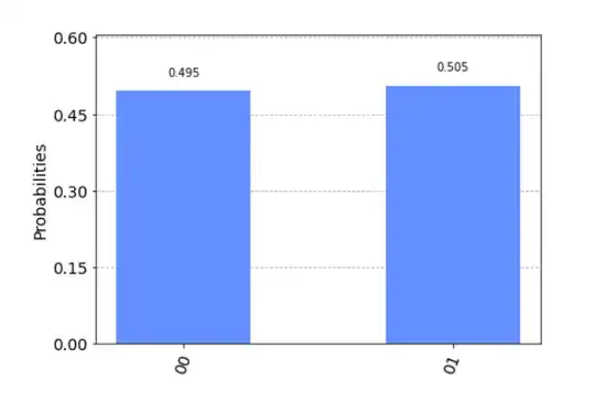

This shows that in a simulation, I have a given probability of getting either $|00\rangle$, $|10\rangle$ or $|11\rangle$ . Yet, this is what happens:
#prepare circuit
circuit = QuantumCircuit(2)
circuit.ry(Parameter('alpha'),0)
circuit.cry(Parameter('beta'),1,0)
#add parameters and measure parameterized_circuit = qc.bind_parameters(parameters) parameterized_circuit.measure_all()
#prepare simulation simulator = QasmSimulator() compiled_circuit = transpile(parameterized_circuit, simulator)
#run, get counts and visualize job = simulator.run(compiled_circuit, shots=10000) result = job.result() counts = result.get_counts(parameterized_circuit) display(plot_histogram(counts))
No matter the parameters used, I never get a single $|11\rangle$ state. For exmaple, using the parameters
[np.pi/2, 3*np.pi/4]
results in the following histogram:
Somehow I am thinking that my calculations are wrong, but am not sure. Specially considering that I've done the same thing with $CRY(\theta)$ inversed (so, control qubit is $q_0$ and target is $q_1$), and the results are the same.

The probabilities plot you have at the end is correct. You can see this by two ways, intuition or explicit calculation of the circuit.
1. Intuition:
The second qubit, $q_1$ start in the state $|0\rangle$ and it acts as a control. Thus, it will not change, that is, it will remain in the state $|0\rangle$. Which matches what you have in the probabilities plot. The first qubit undergoes some changes because of the $RY$ gate so hence you expect it to be in the superposition of $|0\rangle$ and $|1\rangle$, which also matches with that plot in your question.
2. Explicit Calculation:
The circuit you had in mind:
q_0: ┤ Ry(alpha) ├┤ Ry(beta) ├
q_1: ──────────────────■──────
is actually have the form
$$ CRY_{1,0} \cdot (RY \otimes I)\cdot |00\rangle $$
Here note that
$$CRY_{1,0} = I \otimes |0\rangle\langle0| + RY \otimes |1\rangle \langle 1| = \begin{pmatrix} 1 & 0 & 0 & 0\\ 0 & \cos \theta/2 & 0 & -\sin\theta/2 \\ 0 & 0 & 1 & 0\\ 0 & \sin \theta/2 & 0 & \cos \theta/2 \end{pmatrix} $$
This is different than what you had. The matrix you had is $CRY_{01}$. The controlled is the first qubit and the target is the secon qubit. Here the control qubit is the second qubit and the target is the first qubit. Now, note that
$$ \begin{pmatrix} 1 & 0 & 0 & 0\\ 0 & \cos \theta/2 & 0 & -\sin\theta/2 \\ 0 & 0 & 1 & 0\\ 0 & \sin \theta/2 & 0 & \cos \theta/2 \end{pmatrix} \begin{pmatrix} \cos\frac{\alpha}{2} \\ 0 \\ \sin\frac{\alpha}{2} \\ 0\end{pmatrix} = \begin{pmatrix} \cos\frac{\theta}{2} \\ 0 \\ \sin\frac{\theta}{2} \\ 0\end{pmatrix} = \cos\frac{\theta}{2}|00\rangle + \sin\frac{\theta}{2}|10\rangle $$
But in Qiskit, it uses little Endian, so you see $|10\rangle$ as $|01\rangle$ instead.
If you want to get the state that you had in mind, perhaps you should switch the control. That is,
q_0: ┤ RY(0.5) ├────■────
q_1: ───────────┤ RY(2) ├
c: 2/════════════════════
