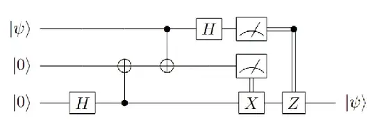

So the usual quantum circuit I know for quantum teleportation allows for the teleportation of the state on a single qubit, in the following way:
Quantum circuit for quantum teleportation of 1-qubit state How easy is to generalize this algorithm to allow for the teleportation of the state of 2 or $n$-qubits?

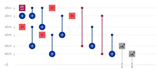

Here is an example of teleporting two-qubits entangled state $\cos(\pi/8)|01\rangle + \sin(\pi/8)|10\rangle$:
Here is a commented code in QASM for the circuit above
OPENQASM 2.0;
include "qelib1.inc";
qreg aSrc[2]; qreg aEnt[2]; qreg bEnt[2]; creg c[2];
//teleported state psi prep. ry(pi/4) aSrc[0]; x aSrc[1]; cx aSrc[0],aSrc[1]; //entangling Alice and Bob h aEnt[0]; //first qubit cx aEnt[0],bEnt[0]; h aEnt[1]; //second qubit cx aEnt[1],bEnt[1]; //connecting psi to quantum channel //between Alice and Bob cx aSrc[0],aEnt[0]; //first qubit h aSrc[0]; cx aSrc[1],aEnt[1]; //secpmd qubit h aSrc[1]; //sending classical bits - teleport. //(here used q-gates for //the circuit simplification) cz aSrc[0],bEnt[0];//first qubit cx aEnt[0],bEnt[0];
cz aSrc[1],bEnt[1];//second qubit cx aEnt[1],bEnt[1]; //measurement at Bob measure bEnt[0] -> c[1]; measure bEnt[1] -> c[0];

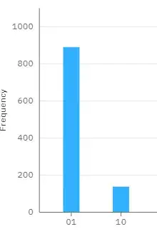

And finally here are results of the teleportation on IBM Quantum simulator (1024 shots):
