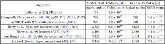

According to Table III of https://arxiv.org/abs/2011.03494 , quantum chemistry algorithms looking at properties of the FeMoCo molecule use half a billion Toffoli gates.

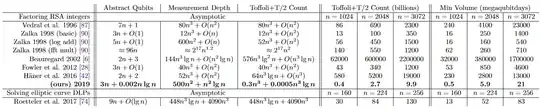

According to Table 1 of https://arxiv.org/abs/1905.09749 , factoring 2048 bit numbers takes 3 billion Toffoli gates:

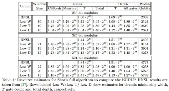

According to Table 1 of https://arxiv.org/abs/2001.09580 , 256 bit elliptic curve discrete logarithms take a few billion T gates:

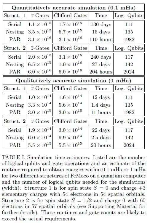

The most useful use-case I found for a big fault-tolerant quantum computer, besides Shor, is a simulation of molecules, which are too hard to simulate on classical computers + demand fault-tolerant computers.
Read this article
Generally speaking, you can see the following demand (depending on the accuracy you want): Table 1
The approximation that they are doing about the number of physical qubits, is ok that this is just approximation because it depends on noise and coding, which is ok to be talked separately not in this context when showing a new algorithm application.
