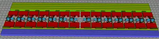

For example, here is a figure of activity over ~150 microseconds of an addition from https://arxiv.org/abs/1905.09749:
The red boxes are magic state factories for Toffoli gates. The stuff outside the red boxes is qubits sitting idle waiting to be operated on. Just outside the red boxes you can see them being routed into the hallways between the red boxes. The stuff between the red boxes is a bunch of routing, a bunch of conditional corrections for the gate teleportation through the magic states, and, hidden away inside each of the blue boxes, contributing almost nothing... the two Clifford gates per ripple carry step from Cucarro's adder.
This is why only the non-Clifford gates matter. Because all the ceremony around getting them done so often determine how the computation is laid out. The Cliffords from the original circuit are almost after-thoughts in comparison. Storage time of idle qubits does matter, but you determine that time based on how long the non-Clifford operations take.
