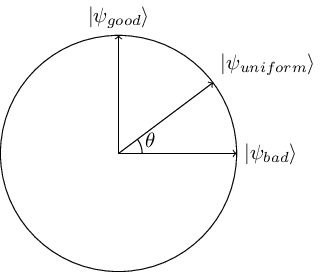

Let's now devise an intuitive visualization of Grover's algorithm. To that end, consider all the quantum states that can be written as $\alpha|\psi_{good}\rangle + \beta|\psi_{bad}\rangle$ with $|\alpha|^2 + |\beta|^2 = 1$, and let's display them in the following picture.
Visualization of Grover
We can use the visualization above to understand what Grover's iterate actually does. Grover's iterate does nothing but rotate any state in the circle above over an angle $2\theta$ counterclockwise. Hence, by applying Grover's iterate multiple times, we can rotate states over angles that are multiples of $2\theta$. How this works can be found in KLM, specifically we see the rotation over an angle of $2\theta$ appear in the last equation on page 160.
Now, suppose that we start with the state $|\psi_{uniform}\rangle$. After applying $k$ iterations of Grover's iterate, we obtain the state $|\psi_k\rangle$. From the picture, using the intuitive interpretation of Grover's iterate, we can easily see that the angle between $|\psi_k\rangle$ and $|\psi_{bad}\rangle$ is $(2k+1)\theta$. Hence, we find: $$|\psi_k\rangle = \sin((2k+1)\theta)|\psi_{good}\rangle + \cos((2k+1)\theta)|\psi_{bad}\rangle$$ As we want to maximize the success probability, we want our state to be as close to $|\psi_{good}\rangle$ as possible. Hence, we want $(2k+1)\theta$ to be as close to $\frac{\pi}{2}$ as possible. Solving this equation, we obtain: $$(2k+1)\theta = \frac{\pi}{2} \Leftrightarrow k = \frac{\pi}{4\theta} - \frac12$$ Recall that $\theta = \arcsin(1/\sqrt{N})$. By making the assumption that $N$ is big, and using the approximation $\arcsin(x) \approx x$ when $|x| \ll 1$, we obtain that our ideal choice for $k$ would be: $$k \approx \frac{\pi}{4}\sqrt{N} - \frac12$$ But we can only apply Grover's iterate an integer number of times, say $k^*$, so we must find the integer $k^*$ that matches $k$ as closely as possible. Hence, we round the quantity on the RHS to obtain (using the notation explained in the box on page 163 of KLM): $$k^* = \left[\frac{\pi}{4}\sqrt{N} - \frac12\right] = \left\lfloor \frac{\pi}{4}\sqrt{N}\right\rfloor$$ as $[x-\frac12] = \lfloor x\rfloor$ for all real $x$. If we trace back where this $\frac12$ comes from, we can see that it originates from the fact that we already start at an elevated angle of $\theta$ in the circle, even before we apply any of the Grover iterates. The floor, hence, is a deep consequence of the fact that the total angle of rotation doesn't have to be all of $\frac{\pi}{2}$, but rather $\frac{\pi}{2} - \theta$.
