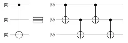

I am wondering how to represent these kinds of circuits as a matrix. Is there any formula for doing this?

Yes, all quantum circuits can be view as a $2^n \times 2^n$ unitary matrix as $n$ is the number of of qubits.
Long way:
For your circuits, first note the circuit identity:
Now, using the circuit on the right, you can see that it can be written as
$$ U = \big(CNOT \otimes I\big)\cdot\big(I \otimes CNOT\big)\cdot \big(CNOT \otimes I\big)\cdot\big(I \otimes CNOT\big) $$ and recall that $$ CNOT \otimes I = \begin{pmatrix} 1 & 0 & 0 & 0\\ 0 & 1 & 0 & 0 \\ 0 & 0 & 0 & 1 \\ 0 & 0 & 1 & 0 \end{pmatrix} \otimes \begin{pmatrix} 1 & 0 \\ 0 & 1 \end{pmatrix} = \begin{pmatrix} 1 & 0 & 0 & 0 & 0 & 0 & 0 & 0\\ 0 & 1 & 0 & 0 & 0 & 0 & 0 & 0\\ 0 & 0 & 1 & 0 & 0 & 0 & 0 & 0\\ 0 & 0 & 0 & 1 & 0 & 0 & 0 & 0\\ 0 & 0 & 0 & 0 & 0 & 0 & 1 & 0\\ 0 & 0 & 0 & 0 & 0 & 0 & 0 & 1\\ 0 & 0 & 0 & 0 & 1 & 0 & 0 & 0\\ 0 & 0 & 0 & 0 & 0 & 1 & 0 & 0\\ \end{pmatrix} $$
and similarly
$$ I\otimes CNOT = \begin{pmatrix} 1 & 0 \\ 0 & 1 \end{pmatrix} \otimes \begin{pmatrix} 1 & 0 & 0 & 0\\ 0 & 1 & 0 & 0 \\ 0 & 0 & 0 & 1 \\ 0 & 0 & 1 & 0 \end{pmatrix} = \begin{pmatrix} 1 & 0 & 0 & 0 & 0 & 0 & 0 & 0\\ 0 & 1 & 0 & 0 & 0 & 0 & 0 & 0\\ 0 & 0 & 0 & 1 & 0 & 0 & 0 & 0\\ 0 & 0 & 1 & 0 & 0 & 0 & 0 & 0\\ 0 & 0 & 0 & 0 & 1 & 0 & 0 & 0\\ 0 & 0 & 0 & 0 & 0 & 1 & 0 & 0\\ 0 & 0 & 0 & 0 & 0 & 0 & 0 & 1\\ 0 & 0 & 0 & 0 & 0 & 0 & 1 & 0\\ \end{pmatrix} $$
From here you can just do usual multiplication to find that $U$, you should end up with something like:
$$ U = \begin{pmatrix} 1 & 0 & 0 & 0 & 0 & 0 & 0 & 0\\ 0 & 1 & 0 & 0 & 0 & 0 & 0 & 0\\ 0 & 0 & 1 & 0 & 0 & 0 & 0 & 0\\ 0 & 0 & 0 & 1 & 0 & 0 & 0 & 0\\ 0 & 0 & 0 & 0 & 0 & 1 & 0 & 0\\ 0 & 0 & 0 & 0 & 1 & 0 & 0 & 0\\ 0 & 0 & 0 & 0 & 0 & 0 & 0 & 1\\ 0 & 0 & 0 & 0 & 0 & 0 & 1 & 0\\ \end{pmatrix} $$

Alternative, shorter way:
@gls commented brought up a different way to do this, and it's easier than thinking than thinking of decompose the gate like we did above.
First, note that CNOT gate can be written as: $$ CNOT_{12} = |0\rangle \langle 0| \otimes I + |1 \rangle \langle 1| \otimes X $$ This is the definition of the CNOT gate. This is assuming that the control and target qubit are next to each other. But if there is an intermediate qubit then we can do it as: $$ CNOT_{13} = |0\rangle \langle 0| \otimes I \otimes I + |1 \rangle \langle 1| \otimes I \otimes X $$
Here note that $$ |0\rangle \langle 0 | = \begin{pmatrix}1 \\ 0 \end{pmatrix} \begin{pmatrix} 1 & 0 \end{pmatrix} = \begin{pmatrix}1 & 0 \\ 0 & 0 \end{pmatrix} \hspace{1 cm} |1\rangle \langle 1 | = \begin{pmatrix}0 \\ 1\end{pmatrix} \begin{pmatrix} 0 & 1 \end{pmatrix} = \begin{pmatrix}0 & 0 \\ 0 & 1 \end{pmatrix} $$
And so you can see that $CNOT_{13} $ will give you the same result as $U$ above.
Regarding to the second circuit:
Now, then for your second circuit, first note that when the CNOT is reversed, that is, instead of $CNOT_{12}$ you are looking at $CNOT_{2,1}$ you can write it as:
$$ CNOT_{2,1} = I \otimes |0\rangle \langle 0 | + X \otimes |1\rangle \langle 1 | = \begin{pmatrix} 1 & 0 & 0 & 0\\ 0 & 0 & 0 & 1 \\ 0 & 0 & 1 & 0\\ 0 & 1 & 0 & 0 \end{pmatrix} $$
Then from here, we have that
$$ CNOT_{3,1} = I \otimes I \otimes |0\rangle \langle 0 | + X \otimes I \otimes |1\rangle \langle 1 | $$
Doing this leads you to the matrix:
$$CNOT_{3,1} = \begin{pmatrix} 1 & 0 & 0 & 0 & 0 & 0 & 0 & 0\\ 0 & 0 & 0 & 0 & 0 & 1 & 0 & 0\\ 0 & 0 & 1 & 0 & 0 & 0 & 0 & 0\\ 0 & 0 & 0 & 0 & 0 & 0 & 0 & 1\\ 0 & 0 & 0 & 0 & 1 & 0 & 0 & 0\\ 0 & 1 & 0 & 0 & 0 & 0 & 0 & 0\\ 0 & 0 & 0 & 0 & 0 & 0 & 1 & 0\\ 0 & 0 & 0 & 1 & 0 & 0 & 0 & 0\\ \end{pmatrix} $$
Again, if you want to use qiskit to generate this matrix, make sure to remember to define your circuit as circuit.cx(0,2) as it is doing the circuit in reverse.
