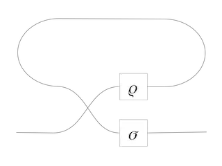

The partial trace of $S_{AB}\rho_A\otimes\sigma_B$ is represented by the tensor network
tensor network for partial trace with swap
which shows that
$$ \mathrm{tr}_A(S_{AB}\rho_A\otimes\sigma_B) = \rho_B\sigma_B.\tag{3a} $$
