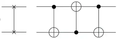

The matrix example you gave is the matrix representation of the SWAP gate. It is not a native gate on a quantum hardware but this is because you can simply implement it as a sequence of CNOT gates as follows:
