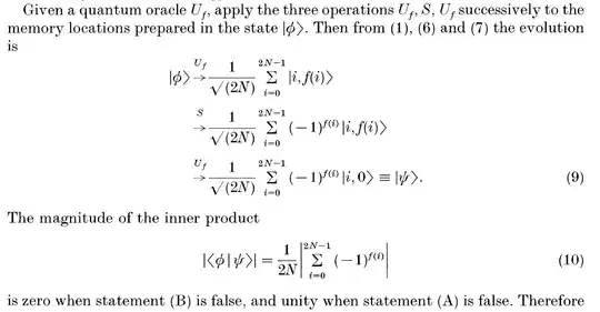

In fact, in the original paper of Deutsch and Jozsa they actually implemented two oracles, here comes their procedure. If you omit the second $U_f$ and get a state $|\psi\prime>=\displaystyle\sum_{i=0}^{2N-1}(-1)^{f(i)}|i,f(i)>$, when quering the expectation value you need to put another $U_f$ on $|\phi>$ to get a state $|\phi\prime>=\displaystyle\sum_{i=0}^{2N-1}|i,f(i)>$. Otherwise, $<\phi|\psi\prime>$ always equals 0.
Deutsch-Jozsa
For your first question, the ability to using n qubits to evaluate say $2^n$ functions is parallelism. You see that for a classical computer, there are $2^n$ operations to evaluate while for the quantum computer you only need to perform the operation once (in this case if you applied n Hadamard gate beforehand). As for how the procedure works, I think what you mean is to perform a measurement and that won't work.
For the Deutsch-Jozsa, after you prepared the state $|\psi>$, what you need to do to extract the result is to get the expectation value, $<\phi|\psi>$, while if you perform a direct measurement $<\psi|\psi>$ you can not get the phase factor because there is no phase difference.
