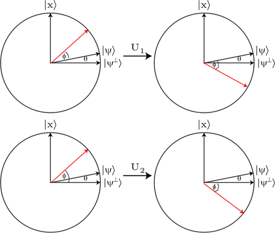

A vector of fixed length within a two-dimensional space can be visualised as the circumference of a circle. So, let's set up a circle with two orthogonal directions corresponding to $|\psi^\perp\rangle$ and $|x\rangle$. enter image description here

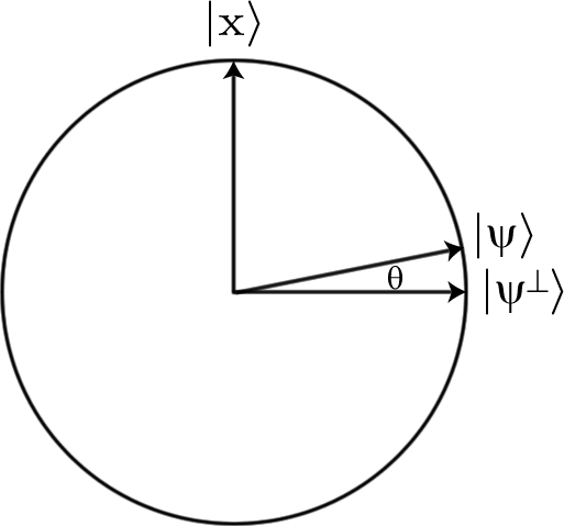

Our initial state $|\psi\rangle$ will have small overlap with $|x\rangle$ and large overlap with $|\psi^\perp\rangle$. If it were the other way around, search would be easy: we'd just prepare $|\psi\rangle$, measure, and test the output using the marking unitary, repeating until we got the marked item. It wouldn't take long. Let's call the angle between $|\psi\rangle$ and $|\psi^\perp\rangle$ the angle $\theta$. enter image description here

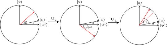

Now let's take a moment to think about what our two unitary actions do. Both have a -1 eigenvalue, and all other eigenvalues +1. In our two-dimensional subspace, that reduces to a +1 eigenvalue and a -1 eigenvalue. Such an operation is a reflection in the axis defined by the +1 eigenvector. So, $U_1$ is a reflection in the $|\psi\rangle$ axis, while $U_2$ is a reflection in the $|\psi^\perp\rangle$ axis. enter image description here
Now, take an arbitrary vector in this space, and apply $U_2$ followed by $U_1$. The net effect is that the vector is rotated by an angle $2\theta$ towards the $|x\rangle$ axis. enter image description here
So, if you start from $|\psi\rangle$, you can repeat this sufficiently many times, and get to within an angle $\theta$ of $|x\rangle$. Thus, when we measure that state, we get the value $x$ with high probability.
