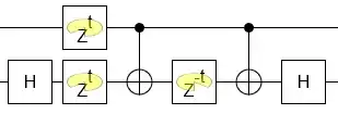

We can implement $CT$ using the following circuit:
This solutions uses an extra gate which isn't available above $R_I(\pi/8) = \sqrt{T}$
Explanation:
We know that $T = \sqrt{S} = Z^{\frac{1}{4}}$. Since $S,T,Z$ are all diagonal matrices hence their controlled versions will also be diagonal matrices $CZ,CS,CT$. Thus $CT=CZ^{\frac{1}{4}}$.
If we can implement the fourth root of $CZ$ using the above gates we will have a $Controlled-T$ gate.
We can implement a Controlled $Z$ gate using $CNOT$ and $H$ gates $$CZ = |0\rangle\langle 0|\otimes I + |1\rangle\langle 1|\otimes Z \\ = |0\rangle\langle 0|\otimes HIH + |1\rangle\langle 1|\otimes HXH \\ = (I\otimes H)(|0\rangle\langle 0|\otimes I + |1\rangle\langle 1|\otimes X)(I\otimes H)\\ = (I\otimes H)CNOT(I\otimes H)$$
We can implement $CNOT^{2t}$ gates using the circuit show in Craig Gidney's Answer enter image description here
We need $CNOT^{1/4}$ hence $t=\frac{1}{8}$. This requires $Z^{\frac{1}{8}}$ i.e $R_{I}(\pi/8)$ and its Adjoint gate.
Let $U = (I\otimes H)CNOT^{\frac{1}{4}}(I\otimes H)$, then $$U^4= UUUU \\ = (I\otimes H)CNOT^{\frac{1}{4}}(I\otimes H) \times (I\otimes H)CNOT^{\frac{1}{4}}(I\otimes H) \times (I\otimes H)CNOT^{\frac{1}{4}}(I\otimes H) \times (I\otimes H)CNOT^{\frac{1}{4}}(I\otimes H) \\ = (I\otimes H)CNOT^{\frac{1}{4}}CNOT^{\frac{1}{4}}CNOT^{\frac{1}{4}}CNOT^{\frac{1}{4}}(I\otimes H) \\ = (I\otimes H)CNOT(I\otimes H) \\ = CZ$$ Thus $U = CZ^{\frac{1}{4}} = CT$
In general for implementing $Controlled-Z^{\frac{1}{2^n}}$ gate we would need $H$, $CNOT$ and $Z^{\frac{1}{2^{n+1}}}$(along with its adjoint version) gate.
