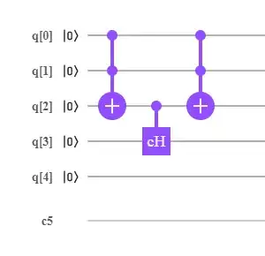

Yes, generally it is possible by using a three qubits Toffoli gate (or series of Toffoli gates) to evaluate whether all controling qubits are in state $|1\rangle$. If this is a case then $C-U$ gate is applied.
Here is an example of $CC-H$ (i.e. controlled-controlled Hadamard gate):
CC-H gate
If qubits $q_0$ and $q_1$ are in state $|1\rangle$, a first Toffoli gate return $|1\rangle$ to qubit $q_2$ and $C-H$ gate acts on qubit $q_3$. Eventually, you have Hadamard gate controlled by two qubits. Qubit $q_2$ is so-called ancila qubit and in the end it has to be in state $|0\rangle$ (so-called uncomputation). This is done by another Toffoli gate because Toffoli is inverse to itself.

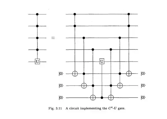

If you want to implement general $C \dots C-U$ gate you can do it followingly:
Please note that in some cases you can construct a simpler circuit (i.e with less quantum gates and those being only two qubits). But generally the above mentioned approach works always.
