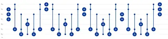

If we are allowed to use ancillary qubits, then this will work (here is an answer about multi-control qubit gates and answer that can show why there are $X$ gates in the following circuit):
The $q[0 - 3]$ qubits are controlled qubits, the $q[4]$ qubit is the target qubit, $q[5 - 6]$ are ancillary qubits. One small optimization can be done by erasing $15$th and $16$th $CCNOT$ gates (nearby two $X$s commute with them). This solution can be extended for $n$ qubits (with more ancillary qubits).
This answer to the related question might be interesting.
