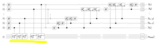

Everything works fine for the 2x2 covariance matrix case but when they extend the circuit to the 4x4 case it's not very clear how they modify the phase kickback part of the quantum circuit. In the picture that shows the general circuit for QPE, some multi-target controlled-U gates are shown:
The image in the paper showing the general circuit for QPE In the 2x2 case this can be made using simple cU3 gates repeated several times as shown in this answer, where the parameters $\theta, \phi, \lambda$ that are needed for the cU3 gate are calculated using the qiskit function euler_angles_1q directly from the $e^{2\pi i\rho}$ 2x2 matrix where $\rho$ is the normalized covariance matrix:

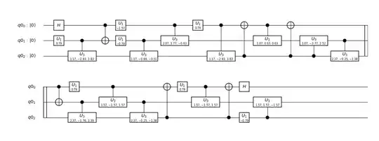

But for the 4x4 case they provide a circuit that does the phase kickback with several U3 gates pca quantum circuit 4x4
My question is:
  1. Since I am a beginner I don't understand how a controlled multi-target gate is decomposed in this chain of gates. Could you please explain me the idea behind this decomposition or give me some resources to start from in order to understand it?
  2. Is it possible to decompose a multi-target cU3 gate using only 2 single target cU3 gates?

How I understand the steps of the get_controlled_circuit() method: 1) it takes your given circuit 2) changes your gates to Qiskit's basis gates (u1, u2, u3, cx). 3) for each given basis gate it modifies and replaces it with the controlled version of it (it has a "dictionary of methods" that implements the controlled circuits for all basis gates).
So, to sum up. Firstly one needs to decompose the given $U$ operator into gates, then for each gate construct the controlled version of it. In other words, if one has a circuit gate_1 gate_2 gate_3, the controlled version of it will look like this controlled_gate_1 controlled_gate_2 controlled_gate_3. If the control qubit is in the $| 1 \rangle$ state all gates will be executed, and if it is in the $| 0 \rangle$ state nothing will happen (as is expected by definition of the control operations). And if you want to implement a controlled version of $U^n$ operator, you can just apply $n$ controlled $U$ circuits.
Final Notes: To obtain a circuit from a given unitary matrix is not a trivial problem and I don't know a general solution for that. Usually, in QPE algorithm implementations, one is given a Hamiltonian $H$ operator expressed by a sum of Pauli product terms and the problem is to simulate $e^{iHt}$ unitary operator to estimate the phase $\varphi$, from $e^{iHt} | \psi \rangle = e^{iEt} | \psi \rangle = e^{i 2 \pi \varphi} | \psi \rangle$, where $| \psi \rangle$ is some eigenstate of $H$. The $H$ is given in this form:
