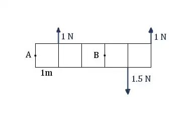

Still, I wanted to test it and made such an image: torques
I calculated the net torque measured from point A (I'll skip the designations such as $m_1, r_1, m_2$ etc. and get to the value):
$$1m\cdot1N + 5m\cdot1N - 4m\cdot1.5N = 0$$
Now, let's calculate the net torque from B:
$$-2m\cdot1N + 2m\cdot1N - 1m\cdot1.5N = -1.5Nm$$
From this it seems, that the body doesn't rotate around an axis in A, but does around the axis in B.

The sum of the torques is equal only when the sum of the forces is zero. In general the torque transfer from point A to point B is
$$\vec{M_B} = \vec{M_A} + \vec{r}_{AB} \times \vec{F} $$
you can see in your case the sum of the forces is $0.5N$, and the distance between A and B is $3m$ so the difference is $1.5 Nm$ which is what you get.
Change the downward force to $2N$ and try it again, only to see the sum of torques is the same regardless of point of consideration.

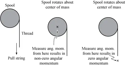

Here's a quick example of what I mean. A spool of mass $m$ is wrapped many times with a string of negligible mass. If you pull the string as shown in the leftmost picture, the spool will translate downward and will also rotate about the center of mass. In this example, you can choose to measure angular momentum (and torque) about the center of mass of the spool. (center picture). By doing so you'll find a non-zero rate of change of angular momentum and a non-zero torque. If instead you measure it along the line of the string (rightmost picuter), you'll find zero torque and zero constant angular momentum, even though it is rotating.
