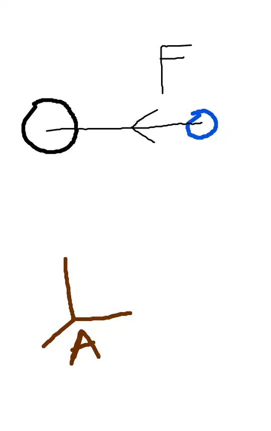

How is the torque zero?
If I take any point in space to be my origin then it is not necessary that the torque on Earth about that is zero.
Below is a sketch, the torques are calculated from A, the two bodies are sun and earth perfect spheres.

If we assume the Earth to be a perfect sphere, then the force, with which the Sun (or the Moon, or any other planet for that matter) acts on the Earth is
$$\vec{F} \, =\, -\,\frac{GMm}{|\vec{r}|^3} \, \vec{r}$$
Where $\vec{r}$ is the vector pointing from the Sun to the Earth. The vector pointing from the Earth to the Sun is then $- \,\vec{r}$ and since the Sun acts with the force $\vec{F}$ from the position $- \, \vec{r}$ relative to the Earth, then the torque is \begin{align} \vec{T} \, =& \, (-\,\vec{r}\,) \times \vec{F} = (-\,\vec{r}\,) \times \left( -\,\frac{GMm}{|\vec{r}|^3} \, \vec{r} \right)\\ =& \, \vec{r} \times \left(\,\frac{GMm}{|\vec{r}|^3} \, \vec{r} \right)\\ =& \, \left(\,\frac{GMm}{|\vec{r}|^3} \, \right) \vec{r} \times \vec{r}\\ =& \, 0 \end{align}
Because by the properties of the cross-product $\vec{r} \times \vec{r} = 0$.
However, in reality, in terms of rigid-body dynamics, Earth is much better modelled as an ellipsoid of revolution and then the gravitational force is not radial, i.e. is not a multiple of the position vector $\vec{r}$ and in that case non-zero torques arise.

An external field (uniform or radial) will cause no net torque on a sphere relative to the center of the sphere ( and will not cause an angular acceleration about that center). If you consider the force on the sphere to be acting about some other (perhaps external) point, then there will be a torque and a change in the angular momentum (associated with the change in linear momentum) of the sphere relative to that other point. The moon can exert a torque about the center of the (non-spherical) earth in two ways: If the moon does not lie in the equatorial plane, it will pull harder on the near side equatorial bulge than on the far side bulge. This contributes to the slow precession of the earth's axis. Also the moon pulls the oceans up on the near side, and the earth away from the oceans on the far side. Then the rotation of the earth drags this tidal bulge to the East. Since the moon pulls stronger on the nearside tide, it causes a torque which is slowly decreasing the angular velocity of the earth (and a reaction which is increasing the velocity of the moon).
