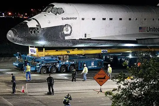

See for example this picture of the space shuttle in LA (photo from http://blog.apt2b.com/wp-content/uploads/2012/10/10-12-12-Space-Shuttle-Endeavour_full_600.jpg):
enter image description here)

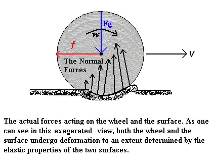

Lots of wheels to spread the load. This limits the force per wheel, and thus the distortion of not only the wheels, but of the road surface. Fewer wheels means each wheel "sinks deeper" into the road below, and tho would mean that the wheel is always "rolling uphill" - a significant factor in rolling friction for heavier objects. This is nicely visualized in this diagram (from http://www.phy.davidson.edu/fachome/dmb/PY430/Friction/actroll.gif)
But as I mentioned - this is unlikely to be a factor in your little car.
